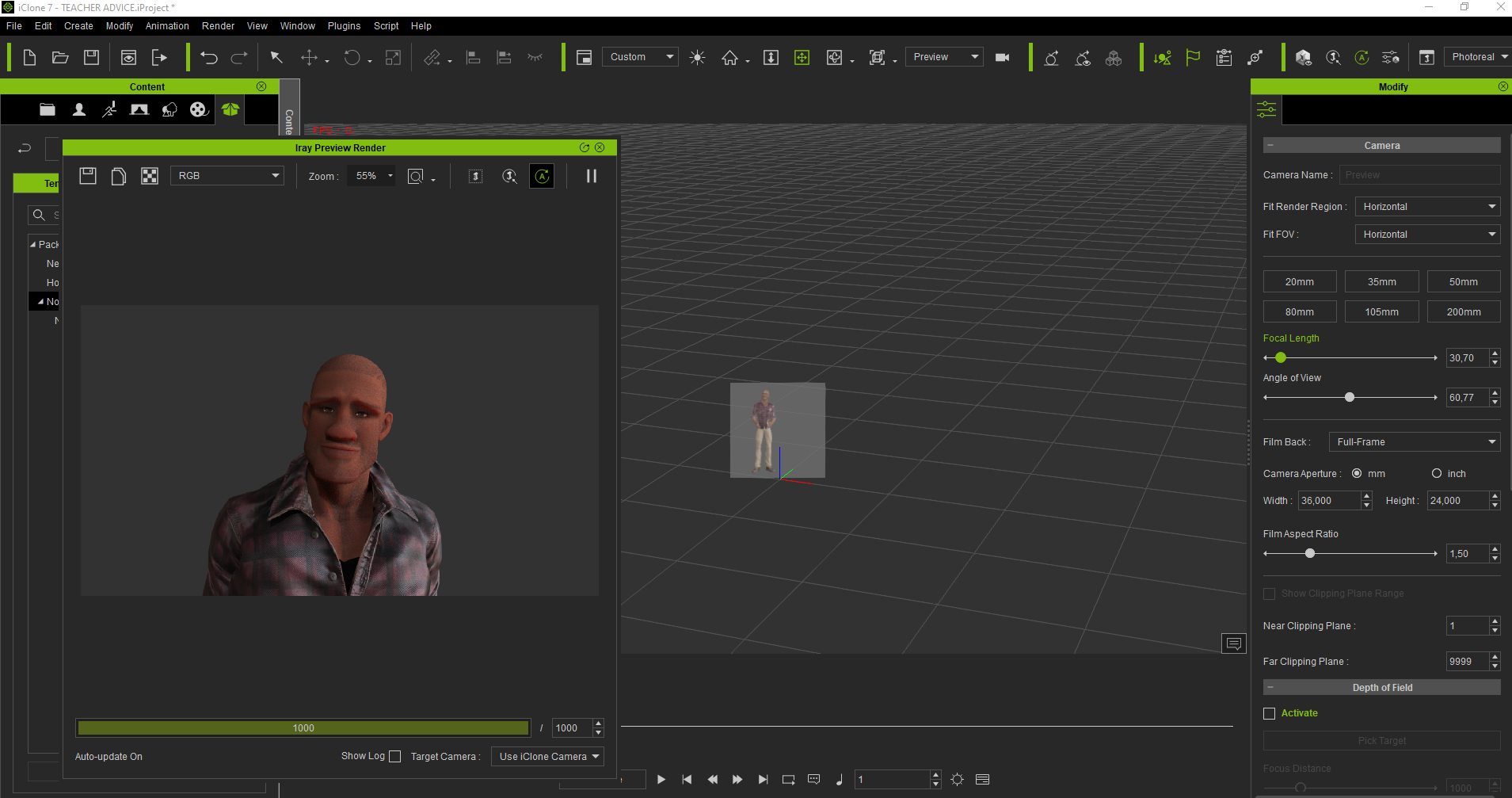

hello folks!...i am running iclone 7.61 and its not showing my project in the viewport but it does show through iray renderer...it seems its not using the GPU...my pc has an NVIDIA RTX 2080 (8 GB), INTEL CORE I7-9700KF CPU with 64gb of RAM...Please kindly assist with this problem.thank you
