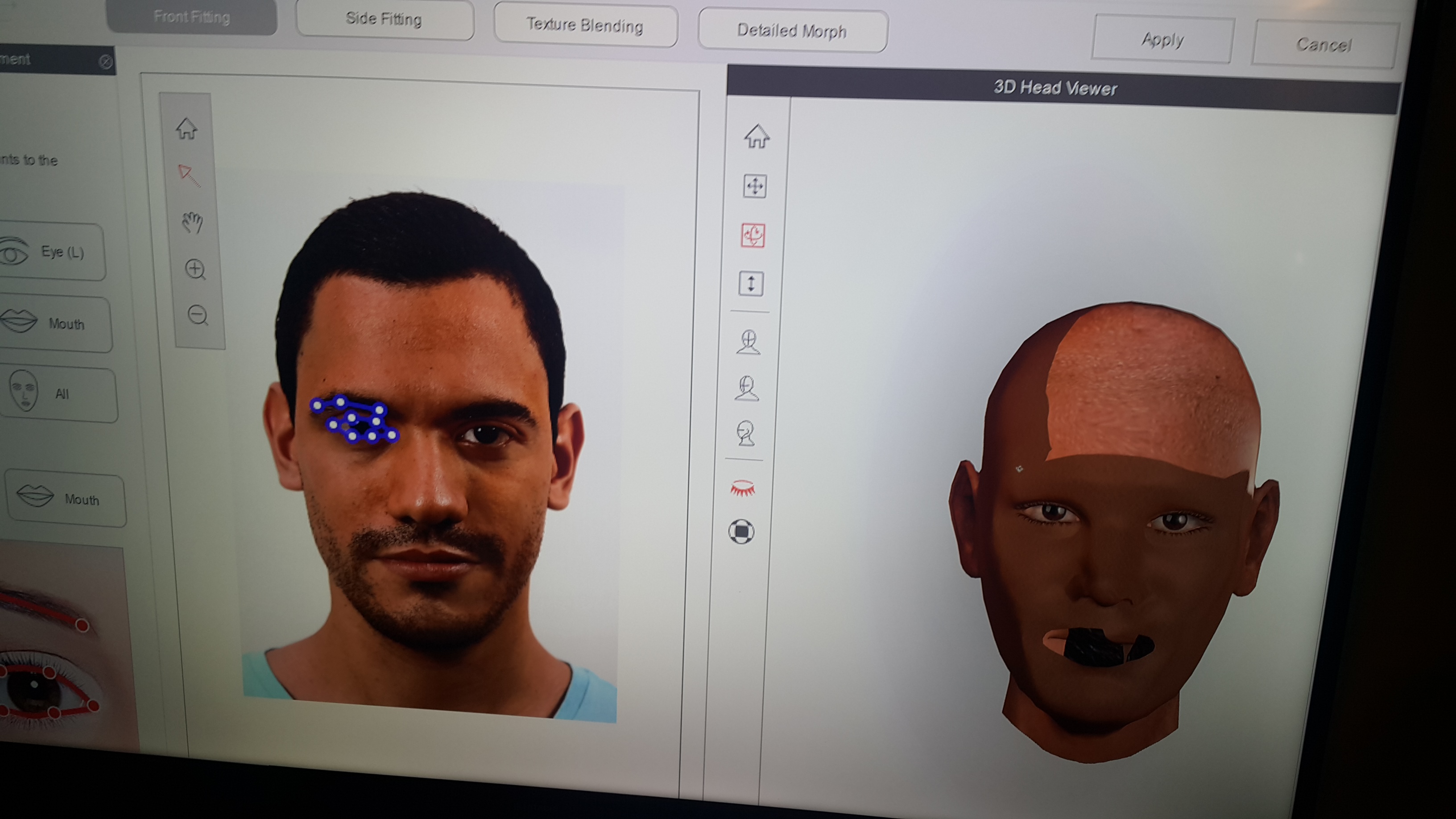

Hello friends, I have a problem with the textures with the crazy talk 8. This happens in characters in the pack and also with those created from photos.

Hi Pablo
Please try updating your graphics drivers. The issue you show is often caused by outdated graphics drivers or an unsupported graphics card.
