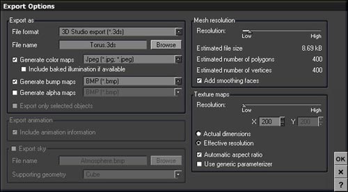

Select “File>Export Entire Scene…” to bring up the Export Options dialog box.
Select "3D Studio scene export (*.3ds) for File format.
Browse to the destination folder and assign file name.
Turn on "Generate color/bump/alpha maps" if there are texture images assigned to the exported objects.
Select Jpeg or BMP format for map images.
Set Mesh resolution, don't set too high the value or it will consume too much system resource and slowdown the performance while editing in iClone.
Polygon values around 5000 are recommended.
Set Texture map resolution, values around 1000x1000 to 2000x2000 are recommended.

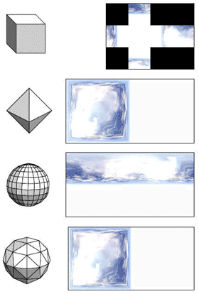

Check "Export sky" to export the sky box/dome
Assign the path and file name, choose Jpeg or BMP format.
Choose Supporting geometry, Octasphere is recommended.

Set object export options including export data type, file format, mesh resolution (if it is a Vue object defined by parametric surface) and texture resolution.
Set mesh and texture map resolutions
